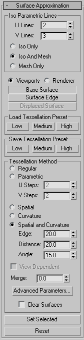

The controls in the Surface Approximation rollout are the same as the surface approximation controls for NURBS surface objects, with two additional buttons: Set Selected and Reset.
Interface
Iso Parametric Lines group
The controls in this group affect the display of the NURBS surfaces in viewports.
- U Lines and V Lines
The number of lines used to approximate the NURBS surfaces in viewports, along the surface's local U and V dimensions, respectively. Reducing these values can speed up the display of the surface, but reduce accuracy of the display. Increasing these values increases accuracy at the expense of time. Setting one of these values to 0 displays only the edge of the object in the corresponding dimension.

- Viewports When chosen, the utility affects how surfaces in the NURBS objects are displayed interactively in viewports, including shaded viewports, and by the preview renderer.
The Viewports surface settings are also used when you apply a mesh modifier such as Mesh Select to the NURBS objects. This is important because it can affect the scene's geometry.
- Renderer When chosen, the utility affects how surfaces in the NURBS objects are displayed by the renderer.
- Base Surface
When on, settings affect entire surfaces in the selection set. Default=on.

Load Tessellation Preset group
Lets you choose a preset low, medium, or high-quality level of surface approximation. While a preset is chosen, the values it uses are displayed in the Tessellation Method group box.
Preset values are saved in the 3dsmax.ini file. You can customize the preset values by using the buttons in the following group box, Save Tessellation Preset.

Save Tessellation Preset group
Click a button to save the current Tessellation Method settings as a new Low, Medium, or High preset. These values are saved in the 3dsmax.ini file.
Customizing preset values overwrites the default presets. To restore the defaults, you can re-enter the default preset values shown above, and then save them with the corresponding button. You can also restore defaults by editing the 3dsmax.ini file to delete the custom preset values.
When you customize the preset values, there is no necessary correlation between the button names and the quality of surface approximation. 3ds Max has no way of knowing how "good" a tessellation is, and you can save a very high-quality surface approximation in the Low preset, for example.
The controls in this group box affect the display of the NURBS surfaces in either viewports, if Viewports is chosen, or by the renderer, if Renderer is chosen. You can choose between five algorithms. Each approximates NURBS surfaces by tessellating them in a different way.
Generally speaking, if the preset values you have chosen give good results, you don't need to adjust the controls in this rollout further. Use them if you encounter problems with the preset alternative.

- Advanced Parameters
Click to display the Advanced Surface Approximation dialog. The parameters in this dialog apply to the Spatial, Curvature, and Spatial and Curvature approximation methods.
- Clear Surfaces
When on, the settings you choose in this utility override all sub-object specific surface approximation settings in the selected NURBS models. When off, the utility affects top-level NURBS models but settings local to individual surface sub-objects remain unaffected. Default=Off.
- Set Selected
Applies the surface approximation values active in the utility to all selected NURBS objects.
- Reset
Resets the values in the utility to the default settings for a NURBS surface.
