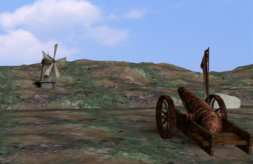

You add realism to scene objects by adding materials to their surfaces. Material texture can include information from bitmap images, as well as bump maps for a 3D effect. In this tutorial the battlefield terrain, as well as the rock, cannon, and windmill, all get their appearance from bitmap texture mapping.
Cannon texture
Rock texture

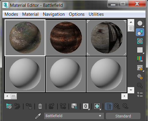

    By default, the Compact Material Editor shows six sample slots, each of which is capable of holding a material. Typically, you would have multiple materials to choose from, so you might prefer to expand the number of sample slots selectable from the editor.

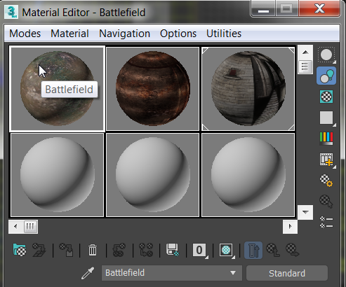

  2. Locate the Battlefield material sample slot and click it.
    Notice that the name Battlefield appears in the Material Name field below the sample slots.
    This material has already been constructed for you. It uses a bitmap as a texture and includes a bump map.
  3. Drag the Battlefield material from its sample slot and drop it onto the Field object in the Camera001 viewport.

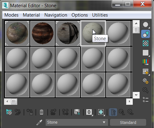

  4. Select the rock object in the viewport, and then drag the Stone material from its sample slot onto the rock object. The stone surface updates to a realistic texture.
    If at first you can't see the sample slot for the Stone material, right-click one of the sample slots and choose 5 X 3 Sample Windows to display more of the slots.

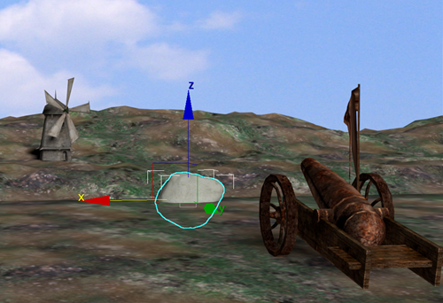

Make the rock more central:
  • Move the rock so it is directly in front of the cannon.
