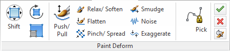

Paint Deform Panel
Paint Deform provides tools for deforming mesh geometry interactively and intuitively by dragging the mouse over an object surface. The primary tools are Shift, for moving vertices with falloff in the direction you drag the mouse, and Push/Pull, for moving vertices inward and outward. Additional tools include Smudge, Flatten, Noise, and more.
  • Ribbon > Freeform tab > Paint Deform panel
Paint Deform tools work the same way at the object level and at all sub-object levels, and are independent of any sub-object selection. To exit a Paint Deform tool, click its button again or right-click in the active viewport.
Interface
Paint Deform panel on minimized ribbon
Paint Deform panel on maximized ribbon
Paint Deform panel floating
