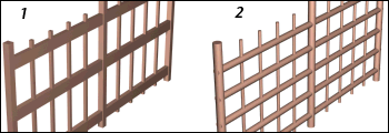

Components of the Railing object include rails, posts, and fencing. Fencing includes either pickets (balusters) or solid-filled material, such as glass or wood strip.
Railings used to create fences in a field.

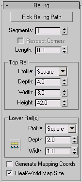

Railing rollout
- Pick Railing Path
Click this, and then click a spline in the viewport to use as the railing path. 3ds Max uses the spline as the path along which to apply the railing object.
If you edit the spline you’ve used as a railing path, the railing adjusts to the changes you make. 3ds Max doesn’t immediately recognize 2D Shapes from a linked AutoCAD drawing. To recognize Shapes from a linked AutoCAD drawing, edit the Shape with Edit Spline in the Modify panel.
Tip: When you create a railing using a closed spline for the rail path, open the Post Spacing dialog, turn off Start Offset and End Offset, and lock End Offset. This will ensure that 3ds Max properly creates the railing with any fill, pickets, and posts you specify.Note: Railing objects that use Pick Path do not stay on the path when substituted using the Substitute modifier. Substituted externally referenced railings do not undo when railings are associated with a path. - Segments
Sets the number of segments of the railing object. Available only when you’re using a railing path.
For a close approximation to a railing path, increase the number of segments. Be aware that a high number of segments increases file size and slows down the rendering speed. You might use fewer segments when the spline path has a low curvature (or none) and fewer segments provide an adequate approximation.
- Respect Corners
Puts corners in the railing to match the corners of the railing path.
- Length
Sets the length of the Railing object. When you drag the mouse, the length displays in the edit box.

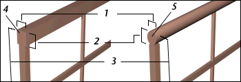

Top Rail group
The defaults produce a top rail component, consisting of one segment by the length you specify, a square profile, four units deep, three units wide, and the height you specify.
1. Width
2. Depth
3. Height
4. Profile for the square top rail
5. Profile for the round top rail
- Profile
Sets the cross-section shape of the top rail.
- Depth
Sets the depth of the top rail.
- Width
Sets the width of the top rail.
- Height
Sets the height of the top rail. During creation, you can drag the top rail to the height you want using the mouse in the viewport. Or you can enter the height amount from the keyboard or use the spinners.
Lower Rail(s) group
Controls the profile, depth, width, and spacing between the lower rails. You specify how many lower rails you want using the Lower Rail Spacing button.
A railing with the rails defined by their profile, depth, and width as planks.
- Profile
Sets the cross-section shape of the lower rails.
- Depth
Sets the depth of the lower rails.
- Width
Sets the width of the lower rails.
Lower Rail Spacing -
Sets the spacing of the lower rails. When you click this button, the Lower Rail Spacing dialog displays. Specify the number of lower rails you want using the Count option. For more information on spacing options in this dialog, see Spacing Tool.

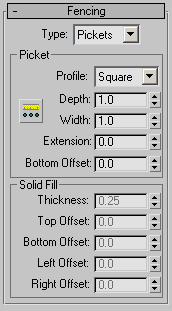

Fencing rollout
- Type
Sets the type of fencing between the posts: none, Pickets, or Solid Fill.
Picket group
Controls the profile, depth, width, and spacing between the pickets. Specify how many pickets you want using the Picket Spacing button. Available only when you set Type to Pickets.
1. A railing with pickets using a square profile
2. A railing with pickets using a round profile
- Profile
Sets the cross-section shape of the pickets.
- Depth
Sets the depth of the pickets.
- Width
Sets the width of the pickets.
- Extension
Sets the amount the pickets extend above the bottom of the top railing.
- Bottom Offset
Sets the amount the pickets are offset from the bottom of the railing object.
Picket Spacing -
Sets the spacing of the pickets. When you click this button, the Picket Spacing dialog displays. Specify the number of pickets you want using the Count option. For more information on spacing options in this dialog, see Spacing Tool.
Solid Fill group
Controls the thickness and offsets of the solid fill between the posts. Available only when you set Type to Solid.
- Thickness
Sets the thickness of the solid fill.
- Top Offset
Sets the offset of the solid fill from the bottom of the top rail.
- Bottom Offset
Sets the offset of the solid fill from the bottom of the railing object.
- Left Offset
Sets the offset between the solid fill and the adjacent left post.
- Right Offset
Sets the offset between the solid fill and the adjacent right post.
