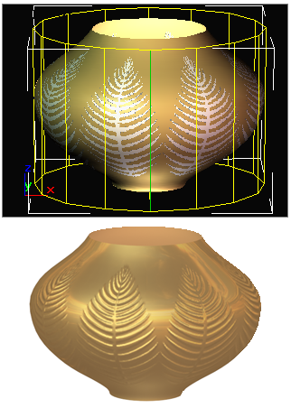

Decoration on the vase is a map positioned by rotating the UVW Map Modifier gizmo.
