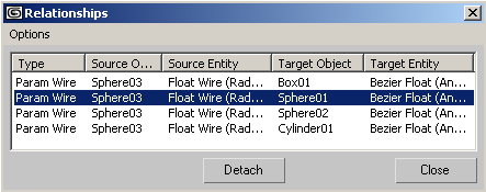

List view displaying relationships
- All Relationships
Opens or redraws List View with all relationships of currently displayed Schematic View entities.

- Detach
In the All Relationships and Selected Relationships views, eliminates the selected relationship and takes it out of the list.
