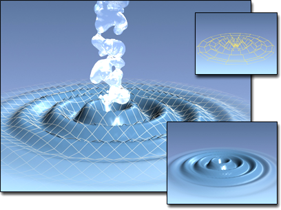

The Ripple space warp creates a concentric ripple through world space. It affects geometry and behaves the same as the Ripple modifier. Use the Ripple space warp when you want the ripple to affect a large number of objects, or to affect an object relative to its position in world space.
Using a ripple to deform a surface
