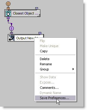

For an ADM suboperator, a different approach is necessary:
- Open Data View and create a suboperator whose parameter you want to override.
- Right-click the suboperator and choose the Save Preferences menu item.

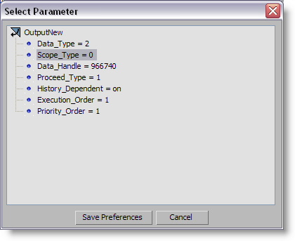

- In the list of the available parameters, highlight the parameter to override and click Save Preferences.
Keep in mind that the labeling of the parameters listed can differ from the suboperator's UI due to the fact that a suboperator may have a complex system of hiding and enabling different UI configurations, depending on the parameters chosen. The Select Parameter dialog lists all parameters available for overriding. To make sure that you override the proper parameter, change the parameter value in the suboperator UI and verify that its value has also changed on the Select Parameter dialog.
