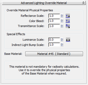

Override Material Physical Properties group
These parameters control the base material’s advanced lighting properties directly.
- Reflectance Scale
- Increases or decreases the amount of energy the material reflects. Default=1.0.
Reflectance Scale increases or decreases the energy of reflected rays.
Tip: To increase self-illumination, use Luminance Scale in the Special Effects group, not this control. - Color Bleed
- Increases or decreases the saturation of reflected color. Default=1.0.
Color Bleed increases or decreases the saturation of reflected color.
- Transmittance Scale
- Increases or decreases the amount of energy the material transmits. Default=1.0.
Transmittance Scale increases or decreases the energy of transmitted rays.
Note: This parameter affects only radiosity. It has no effect on light tracing.
These parameters relate to specific components in the base material.
- Luminance Scale (cd/m^2)
- When greater than 0, scales the self-illumination component of the base material. Use this parameter to have self-illuminating objects contribute energy to the radiosity or light-traced solution. Cannot be less than zero. Default=0.0.
Typically, a value of 500 or more will give good results.
- Indirect Light Bump Scale
- Scales the effect of the base material’s Bump map in areas lit by indirect light. When this value is zero, indirectly lit areas are not affected by Bump maps. This value does not affect the Bump amount in areas where the base material is lit directly. Cannot be less than zero. Default=1.0.
Tip: This parameter is useful because indirect bump mapping is simulated and not always accurate. Indirect Light Bump Scale lets you adjust the effect explicitly.
- Base Material
- Click to choose or edit the Base material. You can also replace the base material with a different material type.
