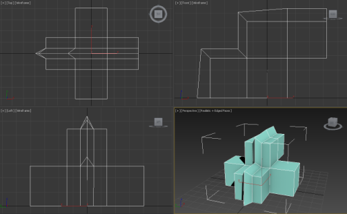

- Create or load a model to apply smoothing to.
For best results, the model should have relatively sharp angles (90 degrees or less) that respond well to the smoothing effect. The following illustration shows a qualifying example:

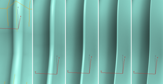

Note: OpenSubdiv does not support the Weight setting for edges and vertices in editable poly objects.However, to get distinct creasing, you might need to increase the Iterations value. This increases the degree of subdivision, providing better mesh resolution for supporting visible creasing.
- On the modifier stack, access the OpenSubdiv entry, then on the General Controls rollout, click the up arrow on the Iterations spinner once, to change Iterations to 2. Note the difference, then continue clicking slowly until you reach 5. Notice what happens to the crease each time you click.
In the following illustration, Crease is set to 0.5, and Iterations increases from 1 to 5, from left to right.
The maximum value permitted with the OpenSubdiv modifier's Iterations setting is 6, which typically supports Crease values of up to 0.5 or so. If you need sharper creasing, you can obtain it as follows:
- At the Edge level of the editable poly object, increase the Crease value. Then, in the OpenSubdiv modifier, turn on Render Iters and set it to a higher value, such as
7. Render the image.
Crease=0.7; Render Iterations=7
