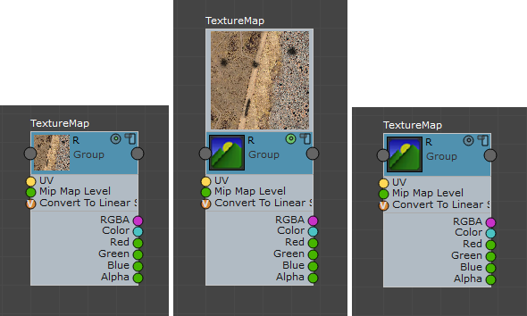

Preview swatch
Click the Render Swatch icon on the top of each node to cycle through displaying: its icon, its small render swatch, and its large render swatch.
In the following example, clicking the Render Swatch icon a first time shows a small preview of a TextureMap node. Clicking Render Swatch a second time shows a larger preview swatch. Clicking Render Swatch a third time returns to displaying the node icon.
This functionality allows convenient visualization and debugging of your shading graph.
Left: Click once to show a small preview swatch.
Middle: Click twice to show a larger preview swatch.
Right: Click a third time to return to the default: displaying the node icon.

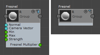

View mode
Click the Hide Inputs And Outputs icon on the top of each node to toggle between displaying the node attributes and hiding the inputs/outputs for a more compact node view.
