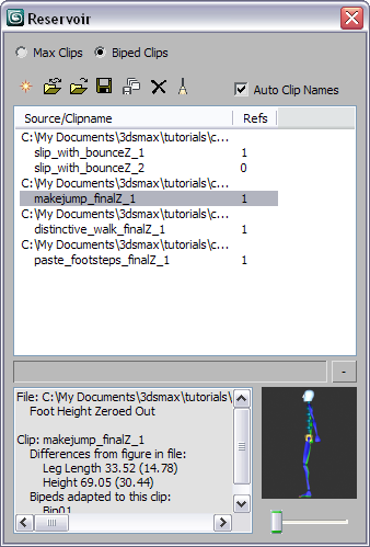

The Reservoir comprises four parts:
- The Reservoir toolbar, where all the commands are located. You can choose between listing biped clips and non-biped clips.
- The Source/Clipname list, where motion clips (BIP files and XAF files) are listed. Instances are grouped together in one listing, while adaptations are listed separately.
- The Clip status window, where you can gather information about the clips used in the Motion Mixer.
- The
Motion Preview, where you can see what a motion looks like before you use it.
Note: The Motion Preview is available only when you choose the Biped Clips option.
Reservoir toolbar
The commands on the main Reservoir toolbar allow you to manage the clips you have in the Motion Mixer and also build up a collection of clips that you may want to use in the future.
- Max Clips/Biped Clips
- Choose to switch between a list of biped and non-biped motion assets. The Max Clips option displays XAF files while Biped Clips displays BIP files.
New Entry- Opens a dialog where you can choose BIP or XAF files to load into the Reservoir. You can highlight multiple files to load by holding down the Ctrl key while you click.
Reload Files- Reloads selected BIP or XAF files listed in the Reservoir.
Load File- Opens a dialog where you can choose a new BIP or XAF file to replace the selected entry.
Save File- Allows you to save a highlighted clip from the Reservoir. The Save As dialog is displayed and you can specify a name and location for the clip you are saving.
Batch Save- Opens the Save Reservoir Items dialog, where you can choose the clip or clips to save.
Delete- Removes a highlighted clip from the Reservoir. All instances of the clip are also removed from the Motion Mixer.
Clean- Similar to Delete, but only removes clips from the Reservoir that are not used in the Motion Mixer.
Auto Clip Names- Names the clip based on the name of the motion file. Turn off to name a clip yourself.
- Source / Clipname list
The Source / Clipname List displays all the clips you have in the Motion Mixer Reservoir. Four pieces of important information can be gathered from this list:
- Drive location where the clips are stored.
- Which clips are currently being used in a mix.
- How many times each instance of a clip appears in the Mixer (Refs).
- Which clips are simply being held in the reservoir, as opposed to being used in the Mixer.
As you add clips to a track, from the Tracks menu or by right-clicking a track, they are automatically added to the Reservoir. If the clip is a new adaptation, the name of the clip is assigned an incremental suffix, such as 1 or 2.
The Refs (Reference) column tells you how many times a clip instance has been used in the Motion Mixer, or if it has not been used at all. If an instance shows a Refs value of 1 or more, it means the instance has been used that many times. If an instance shows a Refs value of zero, it means the clip was once used by one or more bipeds, but is not currently used on any tracks.
If a clip has been added to the reservoir, but has never been placed in the Motion Mixer, only the source path will be listed and no Refs value is displayed.
- [Clip Status window]
The Clip Status window appears at the lower left of the Reservoir and gives you information about how a particular clip has been used. You can get file information, such as the source location of the BIP or XAF file. Clip information is also displayed, like the name of the clip reference as it appears in the Motion Mixer. Information about the biped structure is also listed along with the bipeds to which the clip has been adapted.
- [Motion Preview]
The Motion Preview at the lower right side of the Reservoir shows a thumbnail of the selected clip. Moving the slider across the bottom gives you an idea of what the motion looks like before you add it to a track.
Note: In order for a clip to show in the Motion Preview, it must be a BIP file that has been saved for this version of 3ds Max. If you choose a BIP file that is from an older version of 3ds Max, you will see a warning that the file is obsolete and should be resaved. Until the BIP file is resaved, it will not display in the Motion Preview.Note: The Motion Preview is available only when you choose the Biped Clips option.
