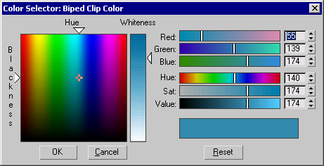

- Track Color...
Allows you to change the color of the clips in the selected object's mixes. Choosing this command displays a Color Selector, where you can specify the clip color.
