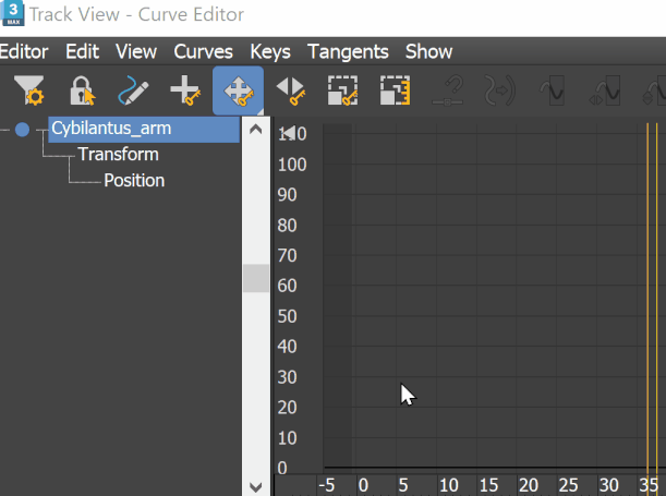

Double-click the label to view the properties of the assigned controller
To view controller properties in Curve Editor:
    Do one of the following:
  • Highlight the label for a parametric or compound controller, right-click the label, and then choose Properties from the shortcut menu to display the properties dialog.
    The dialog title identifies the controller type, the item or object name, and the parameter. For example: Noise Controller:-Box01\Position
  • Double-click the label.
