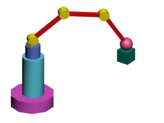

The following example demonstrates how an interactive IK animation works and how it might differ from what you expect. The figure shows an IK structure with its end effector resting on top of a box. The box moves in a straight line over 100 frames.

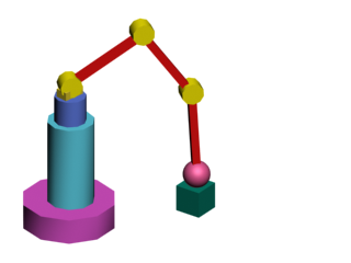

IK tab, turn on Interactive IK. Move the end effector of the IK structure to rest on top of the box at frame 100. The interpolated animation of the end effector follows a natural looking curved path.
You might have expected the IK bone structure to follow the same path as the box. However, the IK solution is only calculated at the keyframes. The positions and rotations of all the objects in the kinematic chain are interpolated between the keyframes to produce the curved result.
To make the end effector closely follow the path of the box, you would have to add more keyframes. You can also use binding and standard applied IK. For information about making the end effector precisely follow the motion of the box, see Animating with Applied IK.
IK structure
Results of animating the box and IK structure
