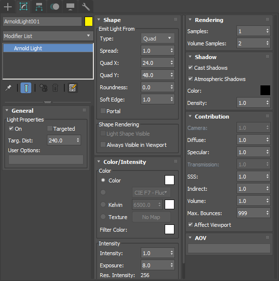

Common Light parameters
As well as honoring the standard 3ds Max light parameters, the Modify Panel will also show the following Arnold parameters:

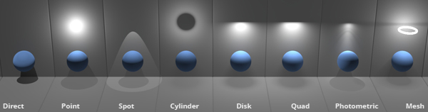

Shape
Type
The shape of the light. Choose from point, distant, spot, quad, disk, cylinder, skydome, photometric, and mesh.
Types of lights available in MAXtoA
Light Shape Visible
When enabled, the shape of the light is visible in the render as a self-illuminated object.
Contribution
Per-light scaling for camera, transmission, diffuse, specular, sss, indirect, and volume. Weights scaling the light contribution to each of those components independently. Should be left at 1 to produce physically accurate results.
AOV Light Group
Per-light AOVs are available via a string parameter. Each light has an AOV parameter which writes out the light contribution to a separate AOV with a corresponding name.

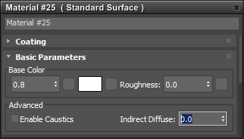

It is not currently possible to make a mesh_light visible to camera rays. A workaround is to add emission to a standard_surface shader assigned to the object. This will give the impression that the geometry is incandescent. Set the indirect_diffuse to 0 for the standard_surface shader assigned to mesh as the mesh_light is already emitting light.
Setting indirect_diffuse to 0 disables GI bounces for the mesh.

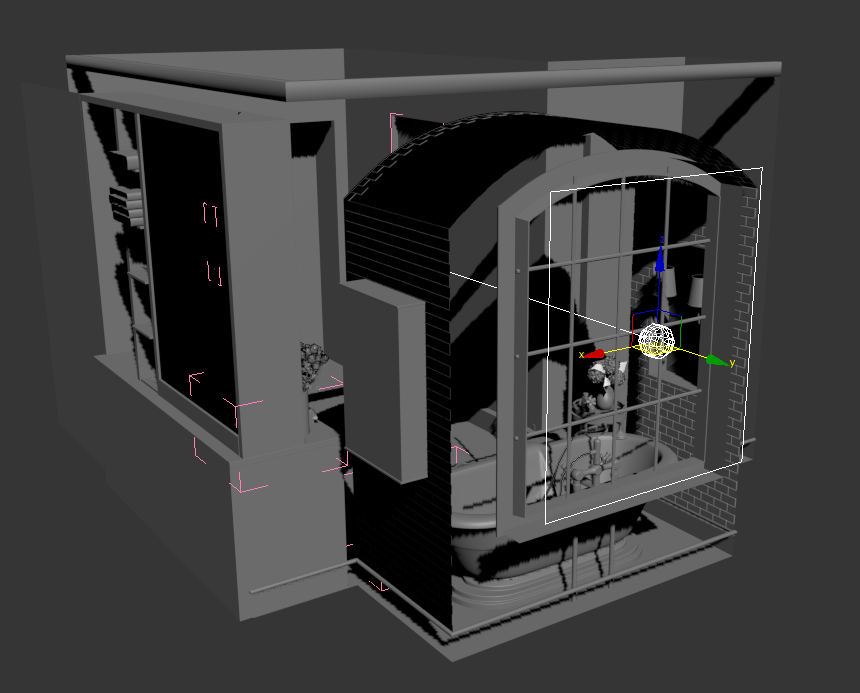

The light portal should be oriented so that it is pointing in through the window as indicated below:
Light portal pointing inwards outside window

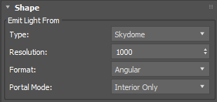

Skydome Light
This simulates light from a sphere or dome above the scene, representing the sky. It can also be used with high dynamic range (HDR) images to perform image-based environment lighting. This is the node that is typically used for lighting exterior scenes. The skydome_light has a texturable color slot so that you can map a texture to be used for IBL.
Simply adding an Environment Map automatically enables a skydome_light with no other input required. The skydome_light and background shader is constructed under the hood, and no extra light creation is required.

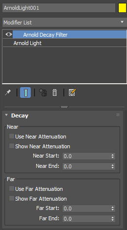

Arnold decay filter Modifier added to Arnold Light

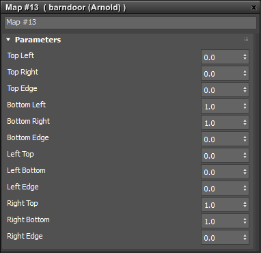

Barndoor
This light filter can only be used with spot lights. Barn doors are opaque moving panels attached to the sides of the light's opening. They are typically used in theatrical and film lighting for additional control over the shape of the light beam.
The barndoor filter's parameters

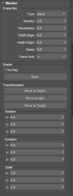

Blocker
Light blockers give flexibility to the lighting TD. They can be used as an artificial method of masking light in a scene without the overhead of adding additional geometry. Used carefully, they provide a degree of artistic freedom, allowing you to define the light boundaries in non-physical ways.
Decay
This filter can be added to all Arnold lights. This is where you will specify the attenuation ranges. All lights in Arnold use a physically-based falloff by default, but the light_decay filter can be used to adjust the falloff for artistic purposes.

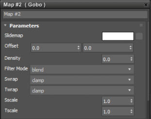

Gobo
The gobo filter can only be used with spot lights. In theatrical stage lighting, a gobo (or "cookie," slang for Cucoloris ) is a thin sheet of metal with holes used to break up the light beam into an irregular, more natural pattern such as tree leaves, etc.
