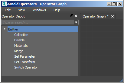

To add operators to the scene, you must first select Arnold->Operator Graph from the top Arnold menu. The core operators are grouped under the Built-in category.

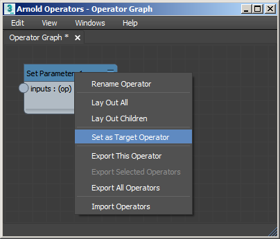

A given Operator is set as the root operator by right mouse clicking on it and selecting Set as Target Operator. The root operator is then framed in green in the editor.
Operator branches can also be saved to .ass file with RMB + Export This/All, and re-imported (or imported into another Arnold plugin) with RMB + Import Operators.

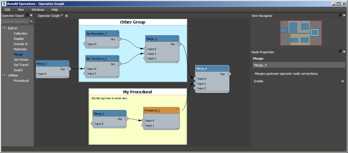

Operators are applied globally to the scene. Any Operator connected to the root operator or to any of its children is evaluated. Operators do not have a particular output type, they just operate on the scene.
