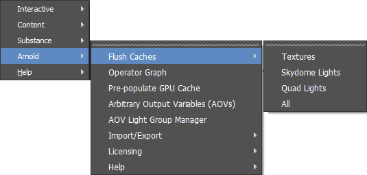

Flush Caches
If you need to modify texture while you are rendering, you have the following options:
- Use the Flush Caches ->Textures command.
- Disable Auto-mipmap and Auto-tile options while you are modifying textures. With this option, you will not have any preprocess before each render.
The Flush Caches menu can be found within the Arnold menubar in the main application window

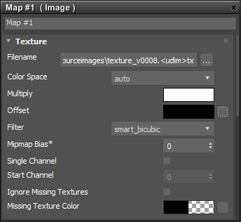

This parameter is visible in the image shader. MIP-mapping Bias offsets the Mip-Map level from which a texture is sampled.

MAXtoA supports the following texture tokens, including both the <tile> (Mudbox) and <udim> (Mari) tokens.
Examples
| Token | Texture Name | Texture Path | Result |
| <tile> | texture _u1_v1.tx | texture |
_u1_v1 |
| <udim> | texture_v0001.tx | texture_v0001. |
1001, 1002, 1003 etc |
Tile
When using the
Image map with <tile> texture token
UDIM values are a way of representing the integer coordinates of a texture, from the coordinates of its bottom-left corner in UV space.
Image map with the <udim> tag
