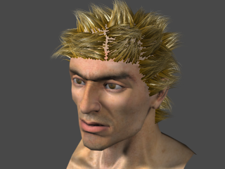

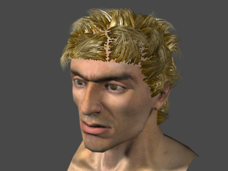

Scruffle
The greater the value, the more Scruffle bends clumps inward, using a random direction for each clump. Range: 0.0 to 400.0.
Clumped hair
Scruffle=125.0
Scruffle=400.0
