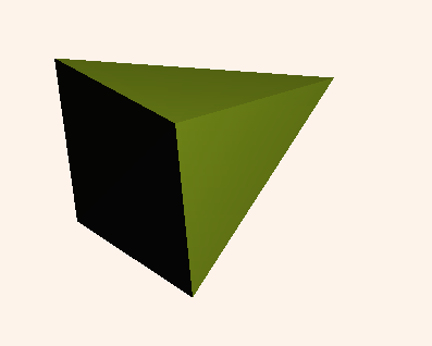

The Delegate is a special helper object used in crowd animation. It serves as an agent for motion created by a Crowd Helper Object and its behaviors. The Crowd object controls any number of delegates, whose motion can then be imparted to a biped or other object. Delegates cannot be rendered.
  • Create panel > (Helpers) > Object Type rollout > Delegate
The delegate object is shaped like a pyramid. By default, the point of the pyramid indicates the forward direction, the delegate's local Y axis.
