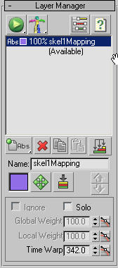

Once you have begun the mapping process, you will notice that a new layer has been added to the bottom of your CATRigs layer list. This layer uses special controllers that hold 3ds Max animation constraints. It also stores the offset, and can scale the transferred motion to fit smaller characters.

  1. Start by going to the Motion panel Layer Manager and deleting any animation layers created by automatic mapping.

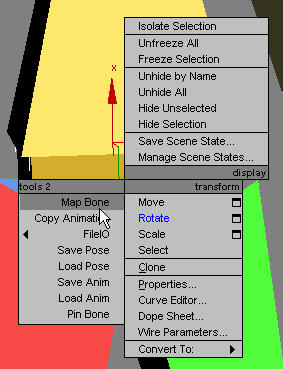

  4. Map another major component, such as the ribcage. For this you can use the right-click menu Map Bone function, after first selecting the CATRig ribcage.

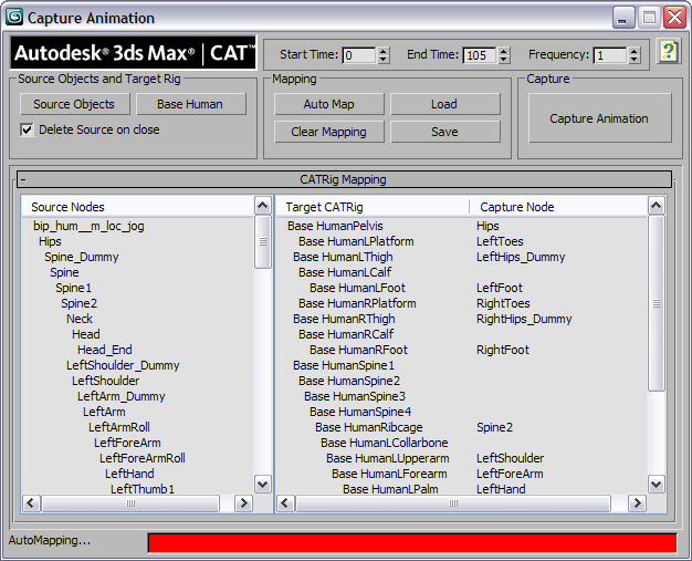

To use Capture Animation with motion-capture data imported directly onto the CATRig:
  1. Access the Capture Animation dialog by importing motion-capture data directly onto the CATRig.
  2. On the Capture Animation dialog, expand the CATRig Mapping rollout.
    You can see both hierarchies in the Source Nodes and Target CATRig lists. The Capture Node list, which shows the source nodes whose animation will be captured by the corresponding CATRig bones, is populated by the Auto Map function. Auto Map is performed automatically during the import process.
  3. Check the Layer Manager rollout on the Motion panel.
    It contains a mapping layer created by Auto Map.
  4. Click Capture Animation.
    The source rig animation plays while the animation is transferred onto the CATRig in a new (“Collapsed”) animation layer, which now also appears in the Layer Manager list.
  5. Click the Close button (X) in the top-right corner of the Capture Animation dialog.
    If Delete Source On Close is on, a small dialog opens asking whether to delete the source hierarchy and remove the mapping layer. Click Yes to do so, or No to keep both. In general, click Yes.

  7. On the Capture Animation dialog, expand the CATRig Mapping rollout.
    You can see both hierarchies in the Source Nodes and Target CATRig lists. No mapping has been done yet; thus, the Capture Node list is empty, and the Capture Animation button is unavailable.
  8. Click the Auto Map button.
    After a short pause, the Capture Node list shows the source nodes whose animation will be captured by the corresponding CATRig bones.
  9. Click Capture Animation.
    The source rig animation plays while the animation is captured onto the CATRig in a new animation layer, which appears in the Layer Manager list.
  10. Click the Close button in the top-right corner of the Capture Animation dialog.

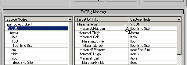

    If Auto Map’s results don’t meet your mapping needs, you can map bones manually with either of the following methods:
  • From the Source Nodes list, drag a bone to map to the comparable item in the Target CATRig list. For example, you would drag a source pelvis bone to the CATRig pelvis bone.
    After you release the mouse button, the source bone name appears in the Capture Node list next to the target bone to which it’s mapped.
  • Select the target bone to map to, right-click it, and from the Tools 2 quadrant, choose Map Bone. Then click the source bone to map to.
    The Map Bone quad menu command appears only after you’ve mapped at least one bone using the manual method (see preceding).

Source Objects
Click to choose the hierarchy from which to capture animation. During motion-capture import this is the hierarchy created from the motion-capture data and the objects are selected automatically.
When you use Capture Animation as a utility, rather than as part of the importation process, the button label is replaced by the name of the root node of the hierarchy.
Target Rig
Click to choose the CATRig to which to map the animation. When the Capture Animation utility is called as part of the import process, the Target Rig is the rig you are capturing onto, so it is selected automatically.
Delete Source on Close
When on and you exit Capture Animation, a small dialog appears asking whether to delete the source hierarchy and remove the mapping layer. Click Yes to do so, or No to keep both.

To map rig components manually, drag an item from the Source Nodes list to the corresponding item in the Target CATRig list (for instance, Pelvis to Pelvis). Thereafter, the source node appears in the Capture Node list next to the CATRig node to which it is assigned.
