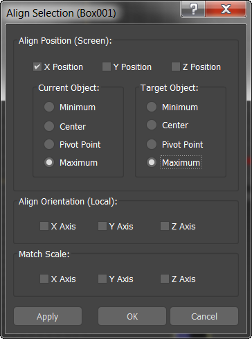

  9. With the Box002 object selected, click (Align), then click the Box001 object.
  10. In the Align Selection dialog Align Position group, turn on X Position and turn off Y Position and Z Position, so that only the left-right positioning of the two objects is set for alignment.
  11. In the Current Object group, choose Maximum and in the Target Object group choose Maximum as well. (Choosing Minimum for both Current and Target objects would align the two boxes on their left sides.) Click OK.
