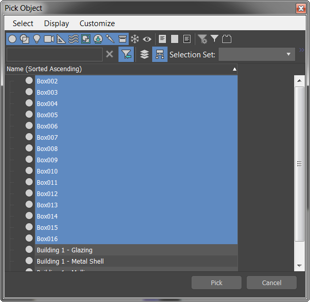

  7. Press H to open the Pick Object dialog. In the list, select all the Box objects, and then click Pick.
    The subtraction operation creates gaps for all the selected array boxes.
