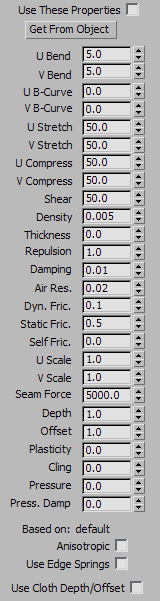

[Group properties]
Use These Properties
Turn on to set the cloth properties for the individual group, using the controls on this rollout. Default=off.
Get From Object
Click to sets the cloth properties of the group to be the same as the object to which the group belongs.
The remaining Properties controls are the same as those found in the Cloth Properties group of the Object Properties dialog for Cloth.
