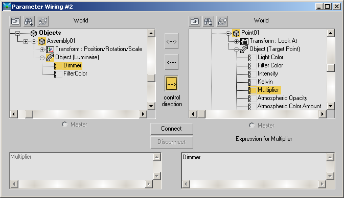

To wire a head object to a light source:
- Create a hierarchy of lights and geometrical objects that models a lighting fixture. Sets up all the necessary IK chains and other constraints that make the model behave properly when the user interacts with it (orients, positions, aims, etc.). Attention: For any photometric lights that you want to control with the head object, be sure to turn on the Multiplier checkbox on the Intensity/Color/Distribution rollout.
- Select all objects in the fixture and define them as an assembly.
When the assembly is selected, the luminaire parameters Dimmer and Filter Color appear in the Modify panel.
- From the Animation menu, choose Wire Parameters
Parameter Wire Dialog. - The Parameter Wiring dialog appears.
- On one side of the dialog, find the assembly and expand the branch titled Object (LuminaireHelper). Click the Dimmer item to highlight it.
- On the other side, find the assembly and expand its hierarchy branch (click the + symbol in the square box). Find and expand the branch for the light source, and then expand its Object branch. Click the Multiplier item to highlight it.
- Between the two hierarchy lists, click the Control Direction arrow button that points from the selected Dimmer item to the selected Multiplier item.
- If you're wiring a photometric light, skip this step. If you're wiring a standard light, or any light whose default Multiplier setting is 1.0, do this:
- The Expression box below the selected Multiplier item contains the word "Dimmer." Edit this to read "Dimmer/100". This divides the Dimmer value by 100, giving a 1:1 value ratio between it and the Multiplier setting.
- Click the Connect button.
Now, when you change the luminaire's Dimmer setting, the light source intensity changes as well.
- If you like, use the same method to wire the luminaire to any additional light sources in the light fixture.
You can also use this method to wire the luminaire's Filter Color parameter to any light sources' color settings.
