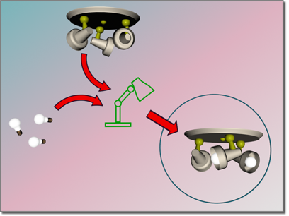

The Luminaire helper object serves primarily as a head, or control, object for light fixtures. When you assemble a set of objects into a light fixture, you specify that a new luminaire object should be used as the assembly head object. The luminaire's parameters, available from the Modify panel, let you control the light sources in the fixture. See Using Assemblies for more information.
  • Create panel > Helpers > Assembly Heads > Object Type rollout > Luminaire button
You can also add a Luminaire object separately from the Create panel, but in general it's not necessary.
A luminaire object groups and manages the components as a whole.

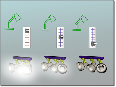

Dimmer
Emulates the dimmer switch of a real-world lighting fixture. The setting determines the percentage of the default light intensity is emitted by the light source of a lighting fixture. You wire this parameter to one or more light sources' Multiplier settings.
Filter Color
An RGB color parameter that you link to a light source's color or filter color.
The Dimmer option can control the intensity of all the lights in the luminaire
