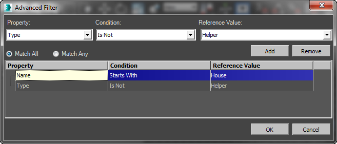

- Add enough terms to create the filter you want to perform.
For example, if you want to show only objects other than Helper objects whose name begins with “House”, your setup would look like this:
Tip: If you add a phrase and then later decide you don’t want to use it, highlight it in the list and then click Remove. - When you’ve set up the filter you want, click OK.
This closes the Advanced Filter dialog and activates the filter, with the result that only items that meet the criteria you specified appear in the Scene Explorer list.
