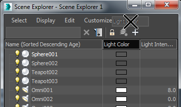

Remove a column from Scene Explorer:
- Drag the column label vertically away from its position until the mouse cursor changes to an X icon.
Removing the Light Color column
- Release the mouse button.
Note: You can’t remove the Name column.
