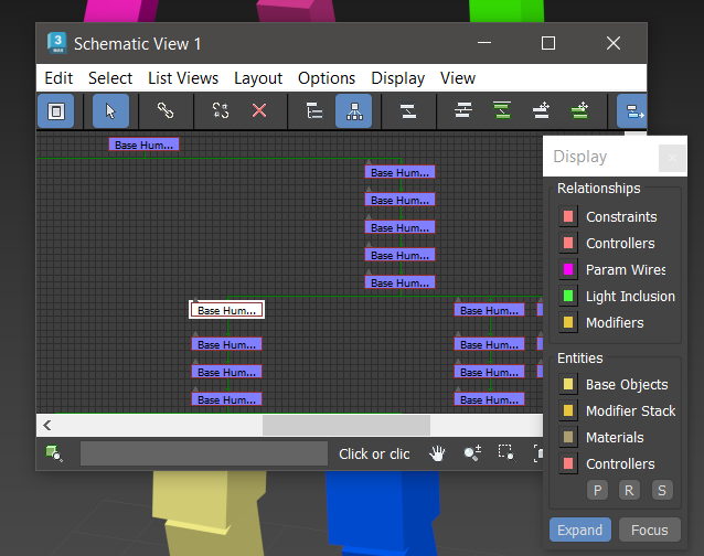

Schematic View is a window that displays the objects in your scene in a hierarchical view. It gives you an alternate way to select and choose the objects in your scene and navigate to them.
Schematic View of a biped
When the Modify panel is open, double-clicking an object modifier in Schematic View navigates the modifier stack to that modifier for quick access to its parameters.

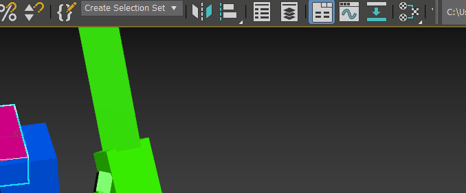

To open Schematic View and display to select objects:
  1. On the main toolbar, click the Schematic View button .
  2. Click the rectangle that contains the name of your object.
You can select any number of objects in Schematic View using standard methods, including Ctrl + clicking multiple objects or drag-selecting a region. For more information, see Using Schematic View.
