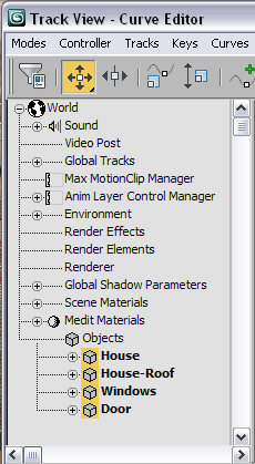

To open Track View and display and select objects:
  1. On the main toolbar, click Curve Editor.
  2. Click any cube icon in the list to select the named object.
You can make the following kinds of selections:
  • Select several adjacent objects in the list. Click the first object, hold down Shift, and click another object elsewhere in the list.
  • Modify the selection by pressing Ctrl while clicking. Ctrl lets you toggle individual items' selection status without deselecting others in the list.
  • Select an object and all its descendants. Press and hold Alt, right-click the object's cube icon—keep the right mouse button held down—and choose Select Children from the menu. Or simply double-click the object's cube icon.
You can open a Track View window for the sole purpose of selecting objects by name. Shrink the window until only a portion of the Hierarchy appears, and then move the window to a convenient area on your screen.
