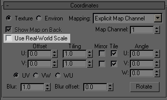

The second requirement is available in the Material Editor. All 2D texture maps, such as Bitmap, provide a Use Real-World Scale checkbox on the Coordinates rollout. Like Real-World Map Size, by default this checkbox is off. When on, the U/V parameter names change to Width/Height and the Tiling label changes to Size. You can then specify the horizontal/vertical offsets and size of the texture map in current system units.
2D map coordinates settings include a Use Real-World Scale toggle.
