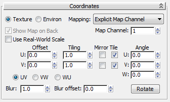

Coordinates Rollout (2D)
Adjusts coordinate parameters to move a map relative to the surface of the object to which it is applied as well as other effects.
  • Material/Map Browser > Assign a 2D Map. > Material Editor > Coordinates rollout

Interface
These controls appear on the Coordinates rollout for many 2D maps:
Mapping Type
Base your choice on how you’re using the map: applied to an object surface, or to the environment:
  • Texture Applies the map as a texture to a surface. Select the type of coordinates from the Mapping list.
  • Environ Uses the map as an Environment map. Select the type of coordinates from the Mapping list:
Mapping
List entries vary depending on choice of Texture or Environ mapping:
  • Explicit Map Channel Uses any map channel. When selected, the Map Channel field becomes active, and you can choose any channel from 1 to 99.
  • Vertex Color Channel Uses assigned vertex colors as a channel. See Editable Mesh for details on assigning vertex color.
    See also Vertex Color Map and Assign Vertex Colors Utility.
  • Planar from Object XYZ Uses planar mapping based on the object's local coordinates (disregarding the pivot point location). For rendering purposes, planar mapping doesn't project through to the back of the object unless you turn on Show Map On Back.
  • Planar from World XYZ Uses planar mapping based on the scene’s world coordinates (disregarding the object’s bounding box). For rendering purposes, planar mapping doesn't project through to the back of the object unless you turn on Show Map On Back.
  • Spherical Environment/Cylindrical Environment/Shrink-wrap Environment Projects the map into the scene as though it were mapped to an invisible object in the background. See Environment Map.
  • Screen Projects as a flat backdrop in the scene.
Show Map on Back
When on, planar mapping (Planar from Object XYZ, or with the UVW Map modifier) projects through to render on the back of the object. When off, planar mapping doesn't render on the object's back. Default=on.
This toggle is available only when Tiling is off in both dimensions. Its effect is visible only when you render the scene.
Note: In viewports, planar mapping always projects to the back of the object, whether Show Map On Back is turned on or not. To override this, turn off Tiling.
Use Real-World Scale
When turned on, applies the map to objects using the real-world Width and Height values instead of UV values. Default = off.
When Real-World Scale is on, the texture placement is relative to the corner of the texture map so alignment with architectural objects likes walls is more efficient. When off, the texture placement is relative to the center of the texture map.
When Use Real-World Scale Is Off
Offset (UV)
Changes the position of the map in UV coordinates. The map moves in relation to its size. For example, if you want to shift the map its full width to the left, and half its width downward from its original position, you enter –1 in the U Offset field and 0.5 in the V offset field.
UV/VW/WU
Changes the mapping coordinate system used for the map. The default UV coordinates project the map onto the surface like a slide projector. The VW and WU coordinates rotate the map so that it is perpendicular to the surface.
Tiling
Determines the number of times the map is repeated along each axis when Tile or Mirror is on (see Tile/Mirror).
Mirror/Tile
Whether or how the map is repeated using the Tiling setting (see preceding). For each axis (U and V), Mirror or Tile can be on, or neither, but not both. For more information, see Tile/Mirror.
  • Mirror repeats and reflects the map left-to-right (U axis) and/or top-to-bottom (V axis).
  • Tile toggles repetition, but not reflection, of the map left-to-right (U axis) and/or top-to-bottom (V axis).
When Use Real-World Scale Is On
Offset (Width/Height)
Move the map horizontally or vertically along the width or height of the object to which the material is applied. The offset distance is relative to the lower-left corner of the map.
UV/VW/WU
Size
Determines the real world width and height of the map.
For example, if you scan a piece of marble that is 12” x 8” and then assign this image as the Diffuse Map, you can type 12” (or 1') and 8” as the Width and Height. This ensures that the scale of the marble is correct in the rendered scene.
Note: The default setting for the texture size can be set using the Default Texture Size option in the Material Editor Options Dialog.
Mirror
Mirrors the map horizontally and/or vertically.
Tile
Turns horizontal and/or vertical tiling on or off.
Note: If the Use Real-World Size switch is turned off in the Material Editor, the Real-World Map Size settings in modifiers like UVW Map or for primitives like Box will not work. Likewise, moving vertices at a sub-object level or scaling an object, in general, will not honor the Use Real-World Scale settings.
Angle U/V/W
Rotates the map about the U, V, or W axis (in degrees).
Note: When using the Environ mapping type, you can rotate the map only on the W axis. Rotating on the U or V axis has no effect.
Rotate
Displays a schematic Rotate Mapping Coordinates dialog that lets you rotate the map by dragging on an arcball diagram (similar to the arcball used to rotate viewports, although dragging inside the circle rotates along all three axes, and dragging outside it rotates about the W axis only). The Angle UVW values change as you drag in the dialog.
Blur
Affects the sharpness or blurriness of the map based on its distance from the view. The farther away the map is, the greater the blurring. The Blur value blurs maps in world space. Blur is primarily used to avoid aliasing.
Blur Offset
Affects the sharpness or blurriness of the map without regard to its distance from the view. Blur Offset blurs the image itself in object space. Use this option when you want to soften or defocus the details in a map to achieve the effect of a blurred image.
See Blur/Blur Offset.
