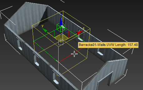

Manipulators for UVW Map
The UVW Map modifier has graphic manipulators to help you adjust the mapping dimensions and tiling. To use these, turn on (Select And Manipulate). The manipulators are available at the main UVW Map level in the modifier stack, and also at the UVW Map modifier Gizmo level.
Manipulators appear as edges at the sides of the gizmo; typically they display as green. If the mapping type and gizmo are 3D, a green cube also appears at the top of the gizmo. When you move the mouse over a manipulator, the manipulator typically turns red to show that dragging or clicking it will have an effect. Also, a tooltip appears, showing the object name, the parameter, and its value.
There are no manipulators for these mapping types:
  • Shrink Wrap
  • Face
  • XYZ to UVW
Note: When Real-World Map Size is on, gizmo manipulators appear only for the Planar and Box mapping types.

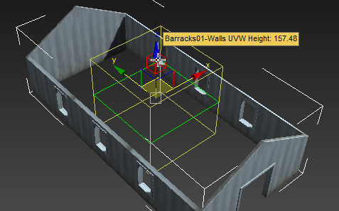

Adjusting an edge manipulator for Box mapping
Adjusting the height manipulator for Box mapping
When you use the manipulator to adjust the Height, the gizmo remains centered on the Length/Width plane, so the Height adjustment scales the mapping.

To use manipulators to control the width and length:
  1. On the Modify panel, choose the UVW Map modifier in the stack display.
    You can also be at the Gizmo level of the modifier.
  2. On the main toolbar, click to turn on Select And Manipulate.
    Green edges appear along the sides of the UVW Map modifier's gizmo. An edge turns red when you move the mouse over it.
  3. Drag an edge of the gizmo to adjust the width or length.
    A tooltip shows the new width or length value.
To use manipulators to control vertical scale:
    For 3D mapping types, a green cube appears at the top of the UVW Map modifier's gizmo. The cube turns red when you move the mouse over it.
  3. Drag the cube to adjust the height of the gizmo.
    A tooltip shows the new tiling value in the vertical dimension.

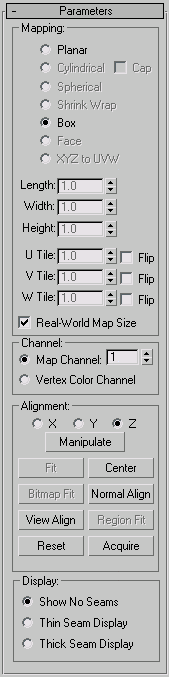

Parameters rollout
Mapping group
Determines the type of mapping coordinates used. Different kinds of mapping are distinguished by how the map is geometrically projected onto the object and how the projection interacts with the object's surfaces.
Note: When Real-World Map Size is on, only the Planar, Cylindrical, Spherical, and Box mapping types are available. Similarly, if one of the other options (Shrink Wrap, Face, or XYZ To UVW) is active, Real-World Map Size is unavailable.

Length, Width, Height
Specify the dimensions of the UVW Map gizmo. The default scale of the mapping icon is defined by the largest dimension of the object when you apply the modifier. You can animate the projection at the gizmo level. Note the following facts about these spinners:
  • The dimensions are based on a bounding box of the gizmo.
    The Height dimension is unavailable for the Planar gizmo: It does not have depth. Likewise, the dimensions for Cylindrical, Spherical, and Shrink Wrap mapping all display the dimensions of their bounding box and not their radiuses. No dimensions are available for the Face map: Each face on the geometry contains the entire map.
  • The three dimensions are set to 1 or 2, depending on map type and dimensions, when you load files created in Autodesk VIZ or earlier versions of 3ds Max. (This maintains compatibility with files from previous releases, in which gizmos were scaled non-uniformly to adjust their dimensions.).
    The dimensions essentially become scale factors rather than measurements. You can reset the values to dimensions by clicking the Fit or Reset buttons, which will lose the original non-uniform scaling.

Real-World Map Size
When on, uses real-world mapping for texture-mapped materials that are applied to the object. The scaling values are controlled by the Use Real-World Scale settings found on the applied material's Coordinates rollout. (Both Real-World Map Size and Use Real-World Scale should be either off or on at the same time.) Default = off.
When on, the Length, Width, Height and Tiling spinners are unavailable.
Channel group
Each object can have up to 99 different UVW mapping coordinate channels; one per modifier. The default mapping channel (from the Generate Mapping Coordinates toggle in the object’s creation parameters) is always channel 1. The UVW Map modifier can specify coordinates for any channel. This lets you have many different sets of coordinates on the same face simultaneously.
Attention: The UVW Map modifier works on only one map channel at a time. When you change channels, 3ds Max copies the current edits to the new channel without alerting you. To apply different UVW mapping in different channels, use multiple modifiers (Unwrap UVW or UVW Map).
If you already have edits in that channel from another modifier, those edits could be overwritten. To ensure preservation of your edits, save them before changing channels and then reload the saved edits as necessary.
Map Channel
Sets the map channel. The UVW Map modifier defaults to channel 1, so mapping behaves in the default fashion unless you explicitly change to another channel. Default=1. Range=1 to 99
If you specify a different channel, make sure any maps in the object’s material that should use that mapping are also set to that channel.
You can use multiple UVW Map modifiers in the modifier stack, each one controlling the mapping coordinates of different maps in a material.
The map channel setting is available in various places in 3ds Max, as follows:
  • Generate Mapping Coords This checkbox, present in the creation parameters of most objects, assigns map channel 1 when on.
  • UVW Map, UVW Xform, and Unwrap UVWs modifiers These modifiers let you set the map channel to 1 through 99, thus specifying which UVW coordinates the modifier uses. The modifier stack can pass these channels simultaneously for any face.
  • Material Editor Channel Assignment You assign the channel to be used by a map on the Coordinates rollout at the map level in the Material Editor. The Explicit Map Channel option must be active.
  • NURBS Surface Objects and Sub-Objects Let you specify which map channel the surface uses.
Vertex Color Channel
Define the channel as a vertex color channel by choosing this option. Be sure to match any material mapping in the coordinates rollout to be Vertex Color as well, or by using the Assign Vertex Colors utility.
Alignment group
X/Y/Z
Select one of these to flip the alignment of the mapping gizmo. Each specifies which axis of the gizmo is aligned with the local Z axis of the object.
Note: These options aren't the same as the Flip checkboxes beside the U/V/W Tile spinners. The Alignment option buttons actually flip the gizmo orientation, while the Flip checkboxes flip an assigned map's orientation.
Manipulate
When on, a gizmo appears on the object that lets you change parameters in the viewport. When Real-World Map Size is on, Manipulate is available only with the Planar and Box mapping types. For more information, see Manipulators for UVW Map.
Tip: Turn on snapping to adjust the mapping precisely.
Fit
Fits the gizmo to the extents of the object and centers it so that it's locked to the object's extents. Unavailable when Real-World Map Size is on.
Center
Moves the gizmo so that its center coincides with the center of the object.
Bitmap Fit
Displays the standard bitmap file browser so that you can pick an image. Unavailable when Real-World Map Size is on.
For planar mappings, the map icon is set to the aspect ratio of the image. For cylindrical mapping, the height (rather than the radius of the gizmo) is scaled to match the bitmap. For best results, first use the Fit button to match the radius of the object and gizmo, and then use Bitmap Fit.
Normal Align
Click and drag on the surface of the object to which the modifier is applied. The origin of the gizmo is placed at the point on the surface where the mouse is pointing; the XY plane of the gizmo is aligned to the face. The X axis of the gizmo lies in the object's XY plane.
Normal Align respects smoothing groups and uses the interpolated normal based on face smoothing. As a result, you can orient the mapping icon to any part of the surface, rather than having it "snap" to face normals.
View Align
Reorients the mapping gizmo to face the active viewport. The size of the icon is unchanged.
Region Fit
Activates a mode in which you can drag in the viewports to define the region of the mapping gizmo. The orientation of the gizmo is not affected. Unavailable when Real-World Map Size is on.
Reset
Deletes the current controller controlling the gizmo and plugs in a new one initialized using the Fit function. Any animation to the gizmo is lost. As with all the alignment options, you can cancel the reset operation by clicking Undo.
Acquire
Effectively copies the UVW coordinates from other objects When you pick an object from which you want to acquire UVWs, a dialog prompts you whether the acquire should be done in an absolute or relative fashion.
If you choose Absolute, the acquired mapping gizmo is positioned exactly on top of the mapping gizmo you pick. If you choose Relative, the acquired mapping gizmo is positioned over the selected object.
Display group
This setting determines whether and how mapping discontinuities, also known as seams, appear in the viewports. The seams appear only when the Gizmo sub-object level is active.
Tip: The default seam color is green; to change it, go to Customize menu Customize User Interface Colors tab, and then from the Elements drop-down list, choose UVW Map.
The options are:
  • Show No Seams Mapping boundaries don't appear in the viewports. This is the default choice.
  • Thin Seam Display Displays mapping boundaries on object surfaces in the viewports with relatively thin lines. The line thickness remains constant as you zoom the view in and out.
  • Thick Seam Display Displays mapping boundaries on object surfaces in the viewports with relatively thick lines. The line thickness increases when you zoom the view in and decreases when you zoom out.
