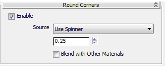

There are three controls for round corners:
Enable
When on, rounds off corners and straight edges at render time. Default=off.
Source
This drop-down list lets you choose between using a value or a map for the radius used to fillet the corners and edges.
  • [Fillet Radius spinner]
    Specifies the radius of the filleted corners and/or edges. Default=0.25.
  • [Map button]
  • Click the button to apply a map to this parameter (in the Slate Material Editor, you can also wire the Round Corners Source socket). Mapping the Fillet Radius creates variations in the amount of corner rounding.
Blend with Other Materials
By default, the rounding effect happens only between surfaces of the same material, but if you turn this on the filleting is performed against any material. Default=off.
