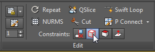

  2. On the ribbon Edit panel Constraints group, activate (Constrain To Edge).
    This ensures that the transform of any vertex will slide along the edges of the polygon to which it belongs.

  6. On the ribbon Edit panel, activate (Constrain To None).
    Tip: When you forget that a constraint is on, surprising things can happen when you transform sub-objects. Because of this, it is a good idea to deactivate a constraint as soon as you have finished using it. Also, the buttons in this set behave like radio buttons. You can’t turn a constraint off by clicking its button a second time: You must activate Constrain To None to deactivate the currently active constraint.

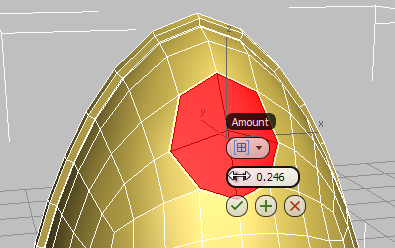

  4. On the Polygons panel, Shift+click (Inset).
  5. On the Inset caddy, drag the Amount spinner (the second control) to a value of approximately 0.25, and then click (OK).
    This creates an inset edge for the selected polygons.

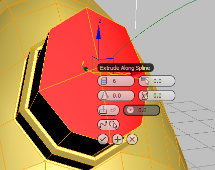

  4. On the Polygons panel drop-down panel, Shift+click Extrude On Spline.
    The caddy controls for spline extrusion are more numerous than for most caddies.

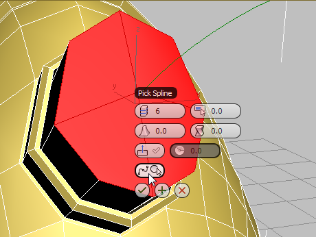

  5. Click the last of the controls, Pick Spline, and then click the spline you drew earlier.
    After you click the spline, 3ds Max grows horns, but these have no taper, yet.

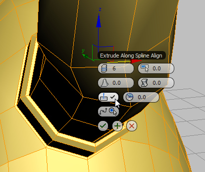

  6. (Optional.) On the caddy, click Extrude Along Spline Align to turn it on.
    3ds Max aligns the spline to the normals of the original faces, making the horns more perpendicular to the rest of the helmet. This might or might not be a good effect, depending on the spline you drew.
    Note: You can also try adjusting the values of Twist and Rotation (available only when Align is turned on).

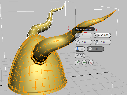

  7. Change the value of Taper Amount to about –0.5, then click (Apply And Continue).
    3ds Max extrudes the horns still further. This is easier to see in other viewports, but you can also navigate the Perspective view, as shown in this illustration.
  8. Change the Taper Amount so the horns come to a point (for the illustrated helmet, the value was –0.955). Click (OK) to finalize these changes and finish creating the horns.
    By extruding the horns along a path, you saved yourself a great deal of back-and-forth between the transform and polygon modeling tools.
