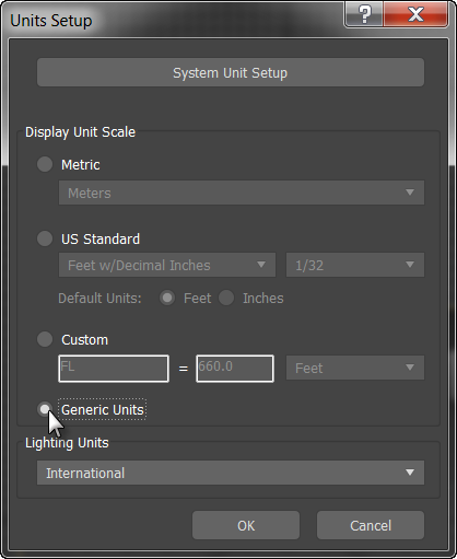

- From the Customize menu, choose Units Setup, and in the Units Setup dialog
Display Unit Scale group, make sure Generic Units is chosen.

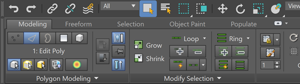

By default, when you start 3ds Max, a minimized version of the ribbon displays directly below the main toolbar.
If you don't see the ribbon, then on the main toolbar, click
(Toggle Ribbon).
- Click the
(Show Full Ribbon) button so that the ribbon expands.
Most of the ribbon tools are inactive, since no editable polygon object is selected in the scene.
- Select the sphere if necessary, then click the Polygon Modeling drop-down at the bottom of the Modeling panel and choose Convert To Poly.
The selected object is now an editable poly, so the ribbon updates to display a range of polygon-editing tools.

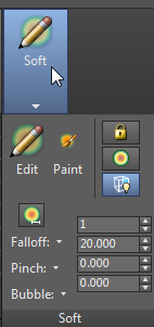

Use Soft Selection to shape the helmet:
- On the ribbon
Polygon Modeling panel, click
(Soft Selection) to turn it on.
When Soft Selection is active, 3ds Max displays the Soft Selection controls on a temporary panel named "Soft" to the right of the existing ribbon controls. If there's not enough room on the ribbon for all of the controls, the panel shows only its title, and you need to click the panel to open its controls.
- On the Soft Selection panel, set Falloff to
30.0.
Move the top vertex of the helmet upward along the Z axis again, until the object appears similar to that in the next illustration.
