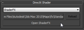

- Open the Material Editor and apply a DirectX Shader material to the plane.
If you use the Slate Material Editor, double-click the DirectX Shader node so you can see its parameters.
- On the DirectX Shader rollout, choose ShaderFX from the drop-down list and then click Open ShaderFX.
3ds Max opens the ShaderFX editor.

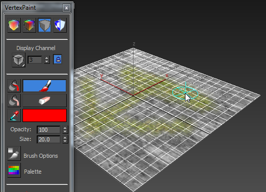

- In a viewport, make sure the Plane object is selected. On the
Modify panel, increase the value of Length Segs and Width Segs to 20. This adds more vertices to your plane to increase definition for vertex painting. - Also on the
Modify panel, apply a VertexPaint modifier to the Plane. 3ds Max opens the VertexPaint Paintbox.
Now you will paint some of your vertices red. The vertices that are painted red will display your grass texture.
- On the Paintbox, click to activate
(Disable vertex color display). - The default color swatch should show black. (If it isn't black, click it and use the Color Selector to change it to black.) Click
(Paint All) to make the Plane black. With vertices assigned the black channel, the plane shows the concrete texture.
- Click the color swatch and change the color to a bright red.
- Click
(Paint) and paint on your plane. The vertices that you paint as red take on the grass texture values. You have now blended your textures by painting your vertices.
