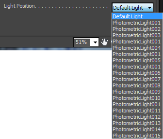

Light Support
Typically FX shaders are coded to use a specific number of lights: usually just a single light. If the FX file you open is coded this way, the shader-specific rollouts display a control that lets you pick the light to use. For example:
XMSL shaders, on the other hand, are not coded to use specific lights, so they use all active lights in the scene.

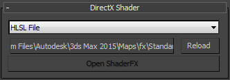

DirectX Shader rollout
- [method drop-down list]
Use this menu to choose the DirectX method:
- HLSL File (The default.) Choose this to use an HLSL (FX) file.
- ShaderFX Choose this to use the current
ShaderFX shader tree as the active DirectX material.
While Use ShaderFX is on, the ShaderFX node tree overrides the current FX or XMSL shader.
Note: While Use ShaderFX is on, the Parameters rollout in the Material Editor shows controls for the ShaderFX shader tree. While it is off, the rollout shows controls for whichever other DirectX shader is active. - Interactive Choose this to use the
Interactive physically-based shader.
The Interactive shader, like ShaderFX, uses the ShaderFX editor.
- [shader button]
While HLSL File is active, click this button to display a file dialog that lets you open a shader. By default, the FX format (Direct3D Effects) is active and the shader is standardfx11.fx.
- Reload
While HLSL File is active, click this button to reload the active shader file. To update a shader file, you can edit it and then click Reload. You don't have to restart 3ds Max to see the effect of the changes to the shader.
- Open ShaderFX
- While ShaderFX or Interactive is active, click this button to open the ShaderFX editor window.

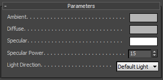

Shader-specific rollouts
The rollouts that appear below the DirectX Shader rollout and above the Technique rollout are the interface to the shader you chose. These rollouts are specific to each shader.
Parameters for the default10.fx shader

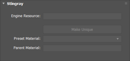

Interactive Rollout
The Interactive rollout is used with Interactive shaders.
- Engine Resource
- The path mapping the material to the Max Interactive engine. This is required since all materials are not included in FBX files, only the ones applied to a node in the scene. If an object is sent from 3ds Max Interactive to 3ds Max, the object's material is automatically mapped to the engine resource. Once the engine resource is mapped, if the material changes in 3ds Max Interactive and is then sent to 3ds Max, the properties will automatically update in 3ds Max.
- Make Unique
- Opens the Shader Graph Editor.
- Preset Material
- To avoid repeatedly creating identical shader graphs, you can create and save a preset shader graph and then reuse the preset next time you create an Interactive shader.
- Parent Material
- A material containing a preset shader graph. You can create child materials based on a parent material. A child inherits the shader graph and material attributes from the parent material.
