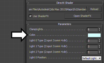

You can add some ShaderFX nodes to the Parameters rollout in the Material Editor. This way, you can adjust the attribute value without having to open the ShaderFX editor.

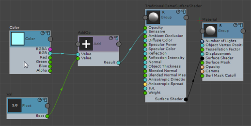

With the ShaderFX editor open, select the node, then on the Properties panel click Expose As Material Input. When you close the ShaderFX editor, the node's attribute is available on the Parameters rollout. You can now adjust this attribute and see it update real time in viewports.
1. Select the node.
2. Turn on Expose As Material Input.
3. The attribute is now available on the Material Editor
Parameters rollout for the DirectX Shader material.
When you turn off Expose As Material Input, a value that you have set in the Material Editor reverts to its original value in ShaderFX.
