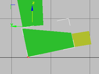

Let's examine the IK constraints for one footstep. The footstep rolls on the heel of the foot, then rotates down flat on the ground, then raises up on the ball of the foot, rotates at the end of the toes, and finally lifts off of the ground.
Touch state: pivot planted at heel at frame 14
The foot is touching the ground at the heel. In the Key Info rollout, Set Planted Key is clicked to set IK Blend=1.0 with object space and Join To Prev Key turned on. A pivot is selected on the heel of the foot.

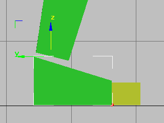

Pivot point shifts to ball of foot at frame 16.
The next keyframe is also a planted key, as the foot is flat on the ground. In the Key Info rollout, Set Planted Key is clicked. The pivot on the ball of the foot is selected.
Planted key set to lock pivot at frame 17
This key has the pivot on the ball of the foot as well. Click Set Planted Key. Two consecutive keys with the pivot at the ball of the foot are necessary to rotate the foot about the ball of the foot.

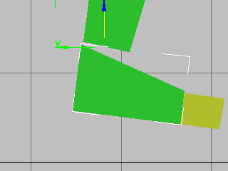

Heel lifts, toe remains flat at frame 18
After rotating the foot about the pivot at the ball of the foot, you set another planted key with the pivot on the toe.

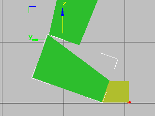

Foot rotates off pivot at end of toe at frame 19.
Here is another planted key with a pivot at the end of the toe; the foot rotates about the tip of the toe.
