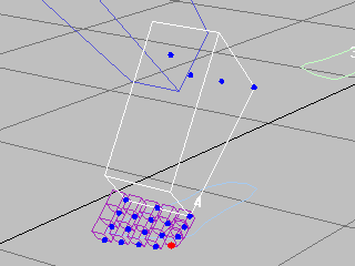

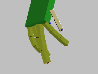

In both freeform and footstep animation, pivots allow you to rotate the biped’s hands and feet around various points.
For example, by activating a pivot on the ball of a foot, you can rotate the foot around the ball of the foot. The biped’s hands and feet have the same number of pivots, and pivot location is similar. Pivots are active only if the biped hand or foot is in world or object coordinate space. In a walking motion, you can pivot on the heel first, then on the ball of the foot, and finally onthe toes. Pivots are essentially extensions of the IK chain.
By setting a planted key for the hand, the hand is anchored in world space: you can move the biped or the collarbone and the hand remains planted. Pivots on the hands make it easy to animate hands and fingers.
While pivots are used in both freeform and footstep animation, the pivots are only visible and accessible when in Freeform mode.

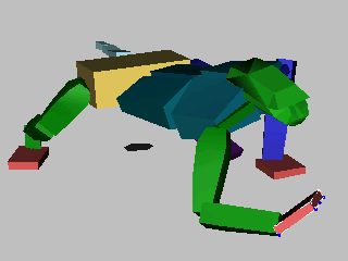

Using IK constraints and pivots on the biped hands and feet allows you to animate quadrupeds.

  1. Select a biped hand or foot.
  2. On the Key Info rollout, click (Set Key), and then choose Object.
    You can also select an object if you like at this point, by selecting a non-biped object in the viewport.
  3. Turn on Select Pivot.
  4. Select a pivot in the viewports.
    Pivots are shown as red dots on the hands and feet. Use wireframe viewport shading if you have problems seeing the choices.
  5. Turn off Select Pivot.
  6. Rotate the hand or foot around the selected pivot.
    Tip: If you find that you are not rotating around the selected pivot, set two consecutive keys at adjacent keys with the same pivot.
