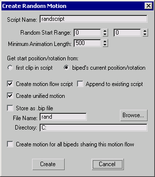

- In the Scripts section on the Motion Flow rollout, click
(Create Random Motion). - On the Create Random Motion dialog, set a value for Minimum Animation Length.
This should be long enough to include the clips you want in the animation.
- Click Create.
A random script is created based on clips in the Motion Flow Graph and the Minimum Animation Length.

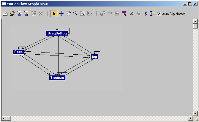

- On the Motion Flow Graph toolbar, click
(Create Multiple Clips). 3ds Max opens a file dialog, where you can choose the location of your BIP files.
- After adding several clips and transitions, click
(Select Clip/Transition) and select all the clips. - On the Motion Flow Graph, click
(Create All Transitions). Click Yes when asked if you want to create a transition from each selected clip to itself.

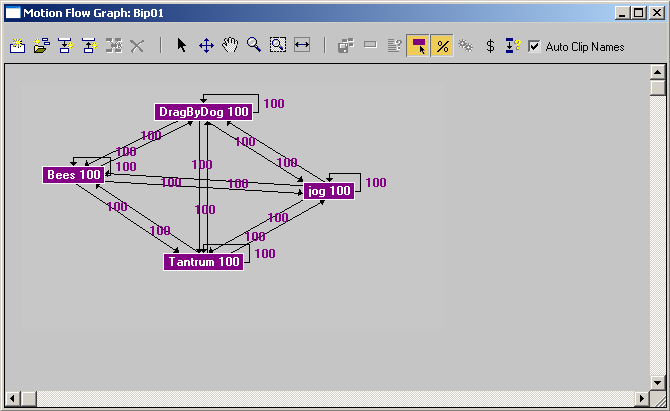

(Select Random Start Clips). All the transitions linking clips are weighted at 100, meaning all the transitions have a even chance of starting first.
- Region-select all the clips in the Motion Flow Graph.
The clips all turn purple and each is assigned a weighting of 100. All the clips have an even chance of starting first.
- In the Motion Flow rollout
Scripts group, click
- Click Create.
3ds Max creates a random script based on clips in the Motion Flow Graph. You can vary clip and transition percentages in the clip dialog or Transition Editor to favor a clip or transition if you like.
