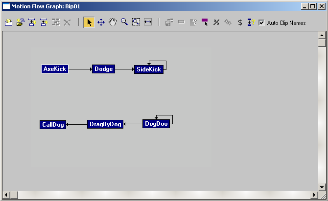

- On the Motion Flow Graph toolbar, turn on either
(Create Transition From -> To) or
(Create Transition To <- From) and then drag from one clip to another clip.
The top set of clips are linked using Create Transition From->To. The bottom set of clips are linked using Create Transition To<-From.

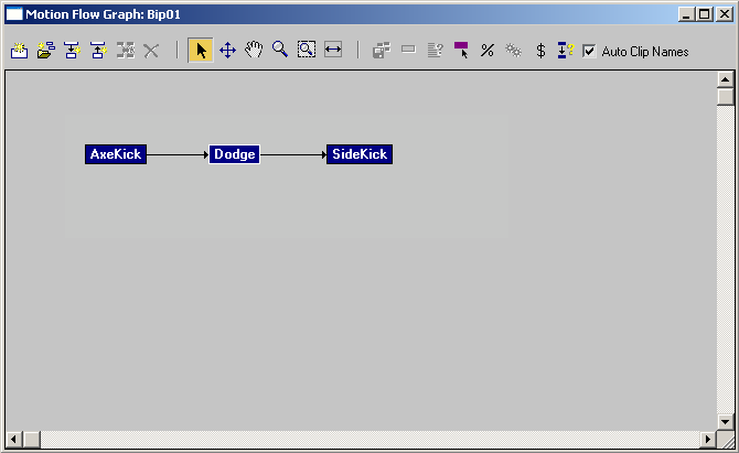

To optimize transitions in the Motion Flow Graph:
- After adding several clips and transitions, click
(Select Clip/Transition) and select one or more transitions.
Selected transitions display in white
- On the Motion Flow toolbar, click
(Optimize Selected Transitions). The Transition Optimization dialog is displayed.
- Click OK.
While the optimizations are being processed, a processing bar scrolls across the top of the Motion Flow Graph window.
