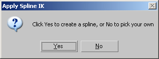

When assigning Spine IK, the tool needs a spline to use to control the IK system. The tool can create a new spline based on the CATBone hierarchy you have selected.

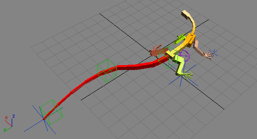

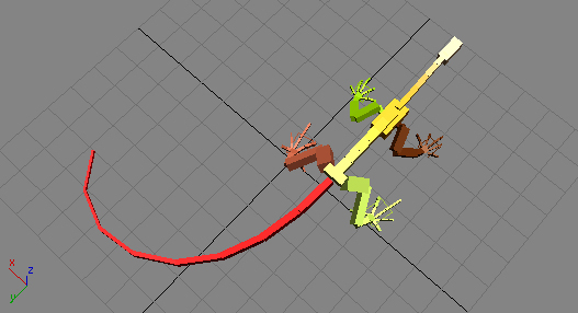

Tip: Always make sure the hierarchy to which you assign the spline IK system is bent before assigning the IK system. Bend the hierarchy in the direction you would like to see the largest range of motion. For example, when constraining the tail of a lizard, bend the tail around the body to help configure the IK system for optimal motion. If the tail is perfectly straight before you assign the IK system, then the bones in the tail could flip around later, when the tail is animated.
Click Yes and a spline will be created using the shape of the tail as a guide. You can also choose an existing spline to control your character.
The spline will be created with the number of knots specified on the Apply IK dialogue. Now you can animate the Point helpers to drive the animation of the tail.

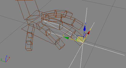

HI/IK System applied to the toe of the Lizard.
