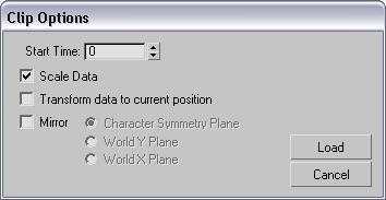

To load a clip:
  1. Double-click a preset in the list or click (Browse) and open a clip file.
    The Clip Options dialog opens.
  2. Set the desired clip options and then click the Load button on the dialog.

Clip Options dialog
This dialog opens when loading a saved clip.
Start Time
The frame at which the clip will start.
Scale Data
When on, the size of the saved data is adjusted to the CATUnits Ratio setting of the current rig. See Understanding CATUnits.
Transform data to current position
When on, the animation is offset to start at the current position of the rig.
Mirror
When on, the animation data is mirrored across the chosen coordinate plane:
  • Character Symmetry Plane The character is mirrored left to right across itself.
  • World Y Plane The character is mirrored across the World YZ plane.
  • World X Plane The character is mirrored across the World XZ plane.
