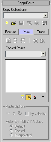

The Copy/Paste rollout on the Motion panel provides controls to help you copy and paste biped postures, poses, and tracks. A posture is the rotation and position of any selection of biped objects. A pose is the rotation and position of all the objects in a particular biped. A track is the animation for any selection of biped parts. For information on working with tracks, see Copying and Pasting Tracks.
You can create and store postures, poses, and tracks in multiple buffers accessed by a drop-down list. You can choose from that list and see a thumbnail image associated with the selection, then paste that selection onto the same biped or any other biped in the scene. You can choose between posture, pose, or track for these operations.
Using these tools lets you work in a traditional pose-to-pose method of animating. You can create a variety of poses and postures, store them in the list, then in Auto Key mode, copy them to any biped at any frame to create animation.
Use the Copy Tracks function to copy the animation of biped parts onto other parts and other bipeds. You can further manipulate these tracks with the Curve Editor and Dope Sheet Editor, using all the standard tools found there. Copy Tracks works with both footstep and freeform animation.
Tip: The copy collections feature acts as an additional layer of organization, allowing your copied postures, poses, and tracks to be grouped together so you can transfer them between files within a single session. After saving a collection, you can load it into another scene either by replacing the current collection or by appending yours to it. If you choose to append, the collection maintains the copy buffer structure.
Note: You must create a copy collection before you can copy a biped's posture, pose or track.

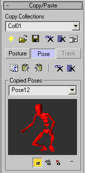

Copying the Entire Biped Pose
The Copy Pose functionality allows you to copy the rotation and position of all the parts of the entire biped at once. It doesn't contain the animation track data, only the individual keys at that frame, and the buttons to copy tracks are unavailable when Copy Pose is in use.
Pose shows the whole biped
You can create animation using Copy Pose by simply copying different poses to the same biped at different frames, and setting keys for those poses. Copy Pose works with the character studio Set Key buttons found on the Key Info rollout, and with Auto Key mode.
Warning: Don't use the Set Key Mode toggle or the large Set Keys button next to Auto Key. These will not produce the correct results.

To copy the entire pose of a biped:
  1. Select any part of the biped whose pose you want to copy.
  2. On the Copy/Paste rollout, click (Create Collection) and rename the new collection Biped Pose.
  3. Click (Copy Pose).
  4. Advance to a new frame or select another biped.
  5. Turn on .
  6. Click (Paste Pose) or (Paste Pose Opposite).
    Tip: You can use Paste Pose Opposite to create symmetrical runs and walk cycles.
