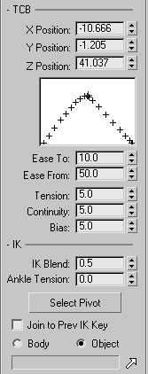

Example: To set TCB/IK Values when pasting postures:
  1. Create a biped and then create a new collection. Name it Hands.
  2. Select the biped's right hand, and on the Key Info rollout, set a key.
  3. In the TCB group, set Ease To to 10, Ease From to 50, and all three TCB values to 5.
  4. In the IK group, set IK Blend to 0.5. Choose the Object [Object Space[ option. Then set another key.
  5. On the Copy/Paste rollout, make sure Posture mode is active, then click (Copy Posture).
