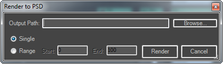

  4. Choose Compositor Create PSD.
    State Sets opens the Render to PSD dialog.
  5. Choose a file name and output path, and whether to render a single frame or a range of frames. Then click Render.
    State Sets saves alpha data in a Layer Mask for each layer, making it easier to control compositing in Photoshop.
    The image is rendered using the Output Size setting on the Render Setup dialog Common Parameters rollout.
