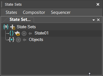

The State Sets dialog contains three main menus: States, Compositor, and Sequencer, plus their corresponding panels. Each panel also contains a number of right-click menus whose contents depend on the context.
The State Sets dialog features a hierarchical list of all defined states, displayed in a tree view. To highlight a state, click its name in the list. To highlight multiple states, drag over the list with the mouse, or press Ctrl or Shift and click.
In addition to the state name, each entry includes buttons for toggling various state properties. Also, if a state contains sub-states or has properties recorded, its list entry starts with a + or - icon to indicate that it can be expanded or collapsed, respectively.

Add State- Adds a new state to the list. To delete a state, click its name and then press Delete or choose Delete from the States menu. Alternatively, right-click the name and choose Delete from the context menu.
- State name
- The name of the state. When you add a state, it uses the default name "State##" with ## being a two-digit number using the lowest available value. For example, if the list contains
State01, State02, and
State04, and you add a state, the new one's name will be
State03.
To rename a state or any other entry, such as a property change, highlight the name, pause for a moment, then click it again and enter a new name from the keyboard. A standard double-click does not enable renaming.

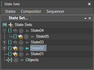

States sets are hierarchal, with a root state, child states, and nested states.
Root State
The root state item, State Sets, is a root node that contains all of your state sets. You can use it to perform global operations such as rendering all states at the same time (right-click State Sets
Render All States) or adding new states.
Child States
Each item at the first level below the root state is called a child state, or simply a state. These are individual objects that you work with when tracking changes in your scene. A special case is the Objects state (described below), which you can use to transfer objects such as lights to the compositing application.
Recording is toggled using the
Record button next to the state name. You toggle a state, activating any recorded changes, by clicking its
Arrow button.
After you record changes, the state's entry in the dialog list contains nested child items that show recorded properties. To see these changes, expand the child state item and adjust them to modify the state.
Nested States
You can nest states, applying the child states to the parent's settings. For example, consider a scene where you have hidden an object in one state and changed render resolution in another state. If you nest the first state within the second, the first state will do both, hiding the object and changing the render resolution.
To nest states within another:
- Highlight the state or states to be nested.
Note: When highlighting a state to nest, be sure to click and release. Dragging over the state names in the list simply highlights the names.
- Drag and drop the highlighted states onto another state to nest them within that state.
To move states:
- First highlight the states to be moved, pause a moment, and then drag the highlighted states either on top of another state, for nesting, or between two other states for reordering.
While dragging, a green highlight at the cursor location shows the destination of the moved states.
