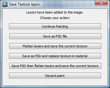

Save Texture Layers Dialog
When you use Viewport Canvas to add one or more layers to a single-layer bitmap texture such as a JPEG or PNG file and then exit the Paint or other tool, Viewport Canvas opens the Save Texture Layers dialog with a choice of options for handling the image. The choices are as follows:
- Continue Painting Returns to the active painting tool (Paint, Erase, etc.) without saving a file.
- Save as PSD file Prompts you for the name and location of the file to save, saves the file, and then restores the original bitmap texture. Your multi-layer painting is stored only in the saved file, not in the scene. You can then use the Material Editor to load the file as a texture map.
- Flatten Layers and save the current texture Combines all the layers into one and saves the image to the current image file.
- Save as PSD and replace texture in material Saves the image in PSD format and replaces the current map in the material with the saved PSD file. This option preserves the layers in the map.
- Save PSD then flatten layers and save the current texture Saves the image in PSD format, then combines the layers into a single layer and saves the flattened image to the current map file. The PSD file is saved separately and is not part of the scene unless you load it manually.
- Discard Paint Discards all painting since the last time the texture was saved, as well as any layers added on top of the background layer. This option effectively undoes any layering operations and reverts to the original, single-layer bitmap.
